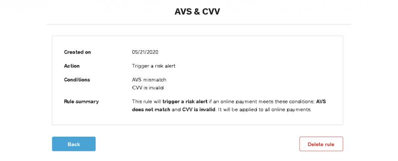

I finally heard from a manager at Square yesterday. It turns out that the customer service person who told me that Square verifies a match between billing address and credit card information was wrong. The manager says that Square DOES NOT verify this information for their API, nor their Virtual Terminal.
Looks like Square can do it. Screen capture from within our account. Or did you mean something different?
Our rule is set to 'Trigger a risk alert'. The other option is to "BLOCK" the payment.

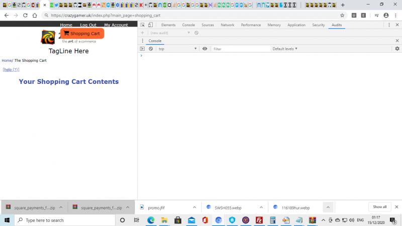

im getting the nonce sql error, i had issues before installing this module with filter by manufacturers and an issue with the sort by dropdown on product listing pages. from reading this thread i am seeing that it may possibly be to do with my template and the java queries coding in php files. Can anyone point me in the right direction to resolve this issue myself hopefully?
I'm on latest version of zen 1.57b and template tableau 2 from the downloads section, picture to follow forgot my address was on it
Re: Square Payment Module for Zen Cart [Support Thread]
"$ is not defined". The $ is probably referring to jQuery. Therefore it suggests your template doesn't have jQuery loaded. Likely your old template had some other outdated way of loading jQuery or javascript code.
Responsive_Classic loads it like this: https://github.com/zencart/zencart/b...eader.php#L138
Tip: one way to determine whether a problem is quite likely with your template is to switch the template temporarily to responsive_classic and see if the problem persists.

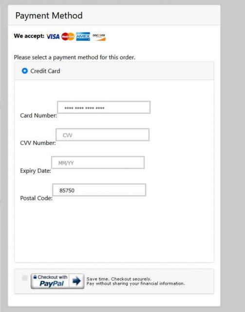

Is this a problem with my template or the payment module?
Any idea on a fix? The AuthNet module displays perfectly. Running an early version of ZCA Bootstrap template.
Attachment 19365
ChrisLane
Probably just a CSS/padding issue related to the <label> tags.
The Square module's input fields are not actually fields on your own site. They're iframes on Square's site. Thus the default padding for label/input combinations may need some small adjustments to accommodate.
