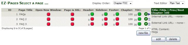

Under Tools > EZ-Pages
Attachment 12473

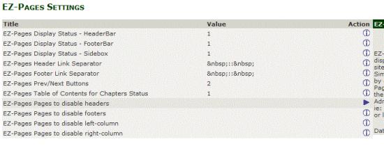

Under Configuration > EZ-Pages Settings
Attachment 12474

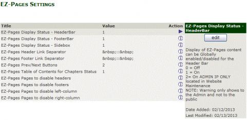

Installed a fresh version of Zen 1.5.1 on my local host.
I am still NOT getting the TOC properly. Following is the screen capture of the setup:
Attachment 12478
Attachment 12479

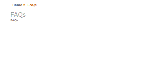

Attachment 12480HTML Code:http://localhost/ZenDemo/index.php?main_page=page&id=1&pos=v&chapter=100
Attachment 12481HTML Code:http://localhost/ZenDemo/index.php?main_page=page&id=2&pos=v&chapter=100
And same with FAQ 3HTML Code:http://localhost/ZenDemo/index.php?main_page=page&id=3&pos=v&chapter=100
I am not getting a listing of the Table of Contents
It does not appear in any of Header, Side box or Footer areas (when all are green / Yes).
