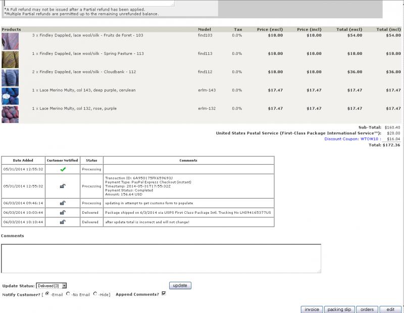

I've got some baffling math going on and not sure what to poke to get Edit Orders to wake up.
ZC 1.5.1, Edit Orders 4.1.4
I had to change one of the items in this person's order. Same price, different style. Everything seemed to be ok yesterday and I printed out a correct packing slip. When I glanced at the order this morning as I was preparing to ship, one item was missing ($17.47); this was not the item that was editted. So I manually added the missing item in and now the math is incorrect.
3@ $18 - $54
1@ $18 - $18
2@ $18 - $36
1@ $17.47
1@ $17.47
subtotal- $160.40 ?
the extra amount comes to $17.46. Note that this was a currency conversion order from Russia and so that would account for the penny.
No error messages or other warnings. There won't be a log file since I did not have this turned on initially. It's not stopping me from shipping but it would be nice to figure out what's going on...

... I had to change one of the items in this person's order. Same price, different style. Everything seemed to be ok yesterday and I printed out a correct packing slip. When I glanced at the order this morning as I was preparing to ship, one item was missing ($17.47); this was not the item that was editted. ...
The list of products and product attributes for an order are stored in the database. You have indicated everything looked correct yesterday. If you still have a copy of the "packing slip" you printed yesterday can you double check and see if everything was correct yesterday?
If the packing slip was correct
This indicates something OTHER than this module most likely resulted in one of the products going missing from the database table "orders_products"... If this is the case it would be a really good idea to determine what the cause was to avoid running into it again.
I'd backup the database and then run a "repair" of the tables (if needed). If no repair was needed, I'd check the MySQL logs and the Zen Cart activity log (to see when and possibly what and who made the change).
If the packing slip was not correct
Are there any Zen Cart debug logs (these are enabled by default in Zen Cart 1.5.1)?
What order total modules are enabled?
Can you provide some additional details about your server environment ("admin" -> "version")?
Have you been able to duplicate this behavior with a test order? Specific steps to duplicate?
If occurs with specific products / attributes, what differs from other products?
linniedarling
... So I manually added the missing item (using Edit Orders) and now the math is incorrect. ...
This is what I would expect if somehow one of the database tables relating to the order were somehow modified outside Edit Orders (or if a 3rd party order total module crashed during the update).
When a product is added the final price is added to the "subtotal" in the database.
When a product is removed the final price is subtracted to the "subtotal" in the database.
Basically what appears to have occurred is somehow the database entry storing the running "subtotal" for the order is out of sync with the actual order's subtotal.
If you know the order number and are comfortable working with phpmyadmin:
- Make a database backup to be on the safe side.
- Correct the products (including attributes, quantities, and price) using "Edit Orders".
- Calculate the correct "subtotal" and store for future reference.
- In phpmyadmin open up the "orders_total" database table and find the row matching the affected "orders_id" with "class"="ot_subtotal".
- Edit both the "text" and "value" columns in the row with the correct "subtotal".
- Go back to "Edit Orders" and click "update".
- Verify pricing is now correct.
NOTE: The above instructions will only work when the subtotal is calculated based only upon the products added to an order. There are some circumstances where the subtotal may contain additional costs or deductions.
