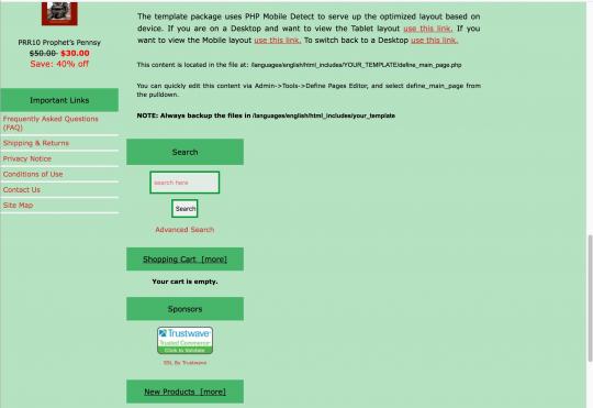

Site still on my development site. Attachment shows lower half of home page with right sideboxes (search and shopping cart shown) in center.
Attachment 17925
You've somehow managed to change the hierarchy of the column divs and added a #bannerThree in between the center column and the .col150 for the right column.
The settings you have would probably work if it didn't have all the announcements in the wrong place.
Without being able to see the php, it appears that you wanted to add the announcements at the bottom of the main content.
Several ways to go from here. Easiest might be to go back to the original file and put the announcements in the define_main_page.php file.
Yes, I've had a banner at the top of the center column for announcements for ages. Didn't realize it screwed up the div's. Would really like to keep the banner in the top of the center column because it's easy to add, delete or change announcements from the admin. If I move them to the define_main_page, I can still edit them in the admin, but they will appear below the "Welcome Guest" text. I think I'll chase down the div problem before going the define_main_page route. Thanks for your help!
Working now. Missed a </div> at the end of the banner html. Thanks for the div hint!

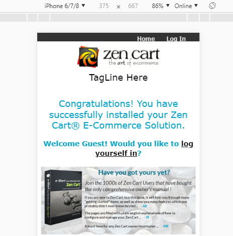

Sorry if I have missed this. I have installed a clean version of Zencart and when resizing my browser to see how it responds when I get to mobile view there is no menu or a collapsible menu. The normal categories in menu are working ok until resized then just disappear. Can anyone suggest how to resolve this?

So turning off Category Tabs Menu adds the mobile menu but applies it throughout all screen sizes. Is there anyway to have both. Only showing one in mobile view and the other in all other viewpoints?
For viewing Mobile view @desktop you should type:
http://www.yoursite.com/index.php?ma..._mode=isMobile
For Tablet:
http://www.yoursite.coml/index.php?m..._mode=isTablet
For turning back to desktop:
http://www.yoursite.coml/index.php?m...mode=isdesktop
and then make your screen smaller or use at Chrome browser the developer tools to see Mobile or other view.
