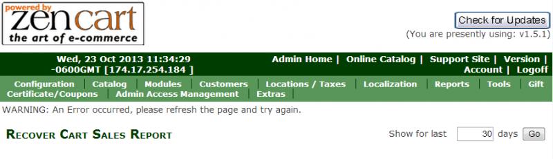

I have v1.5.1 and and doing a new install; I could only get the upgrade-ZC-v-1-5.sql file to upload. When I tried the install-ZC-v-1-5.sql through Tools> Install SQL Patches it fails and says, Warning: An Error occurred,please refresh the page and try again. But since I got positive confirmation that the "upgrade" file took, I uploaded the files to my admin folder. I'm not sure if this is how it is designed to work, but that's what I did.
Now, I have all the RCS menus displaying in Admin. But, even after adding products to my cart and logging off, I don't see anything in the reports. However, I do get an error that says: Warning: Ad Error occurred, please refresh the page and try again.
Attachment 13235
I've double checked my admin folders and everything is uploaded correctly. I suspect it's related to the database, but I have no idea where to start. Any ideas?
