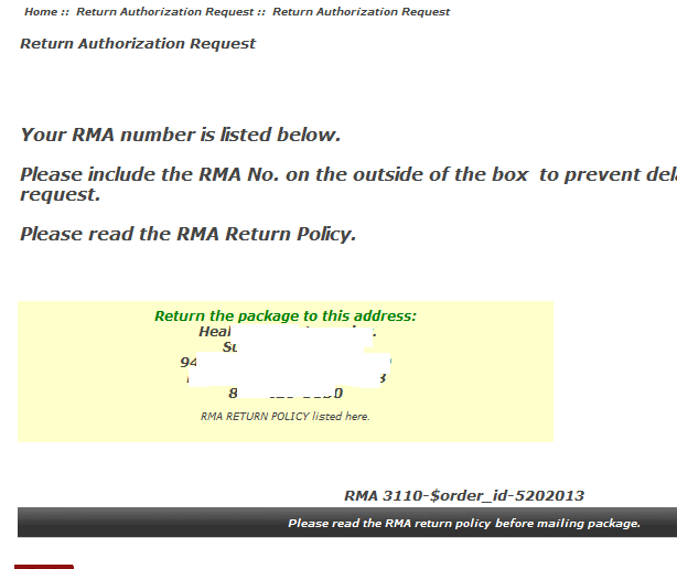

While I have your attention.....
The success page after submission, is there a way to do something like this?
<?php if (RETURN_STORE_NAME_ADDRESS == 'true') { ?>
<h1>$order_number - $item_number</h1>
<h1>Thank you for completing the RMA <BR> Your RMA number is above. Follow these directions.............etc</h1>
<address><?php echo nl2br(STORE_NAME_ADDRESS); ?></address>
<?php } ?>
(on my form I changed Item number to Number of Items)
This way the rma would be the invoice number xxxxx a dash - and the total number of items being returned ie: 42545-2.
All the instructions would be on the success page and no further need to email customer.

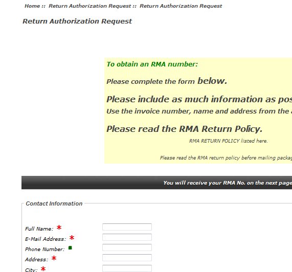

Hello
Can anyone tell me why this code does NOT return the Order ID to the RMA form?
Re: Return Authorization Module (RMA)
I separated the submit rma page from the success page.
I added a generated RMA number.
I would really like the invoice number included in that rma generation.
When the customer is logged in, they can click a button next to their "view" order button
in "View Account".
This should immediately forward you to the rma form with all your personal info fields populated.
Including your invoice order number.
It does carry in the url:
/index.php?main_page=returns&order_id=105308
But does not fill the order number field.
I will post all my upgrades once this is solved. Can anyone help solve this?
