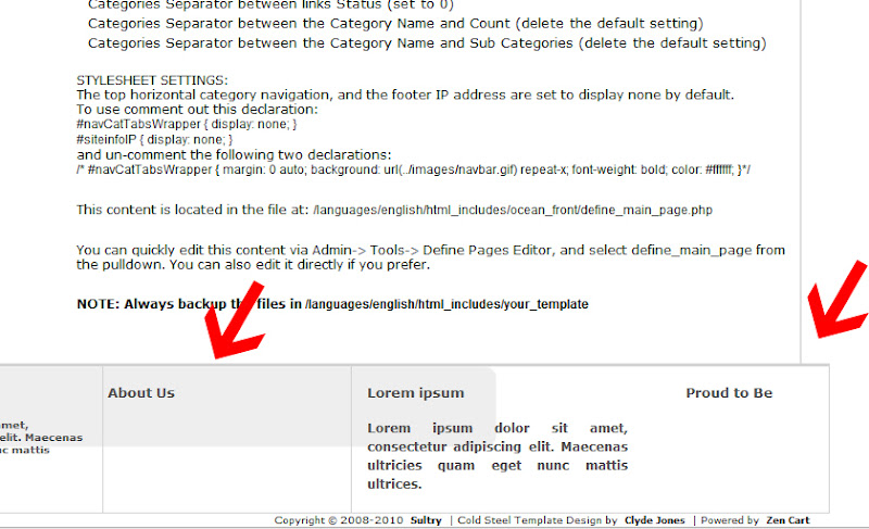

I already tried changing the .centerColumn value and it just moves the text outside the box. Here is a picture of what I am trying to fix. I added a custom footer taken from Rubik Integration template. I want it to align. Also I am trying to get rid of that light gray box inside. I believe its remnant from coldsteel. The red arrows shows the areas I am talking about. Any ideas?

open includes/templates/cold_steel/css/stylesheet.css
find the following declarations; delete the highlighted portions.
adjust the width settings to match the width of the Rubik Integration template footer
#mainWrapper {
margin: 0 auto;
padding:0;
background: url(../images/main_wrapper_middle.gif);
background-repeat:repeat-y;
text-align: left;
width: 917px;
#footer {
margin: 0 auto;
text-align: left;
width: 913px;
height:90px;
#footerLogo {
margin: 0 5px;
padding: 0;
background: url(../images/inr_logo.gif) no-repeat;
float:left;
text-align:center;
height: 78px;
width:249px;
#navSuppWrapper {
margin: 0 5px;
padding: 0;
background: url(../images/footer.gif) no-repeat;
float:right;
font-weight: bold;
height: 78px;
color: #000;
width:619px;
