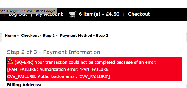

I must be doing something wrong. When I test an EU sandbox card, I dont receive a challenge and the transaction fails with the following.
Attachment 19601
Attachment 19601

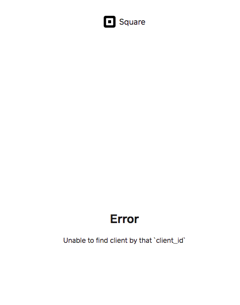

No matter how many times I remove the square module and reinstall, generate a new sandbox OAuth secret & try to use the sandbox credentials, whenever I click the green button in ZC to get tokens via OAuth, I receive this error. If I use my production credentials, the module receives its tokens and becomes active.

I had various issues like this.
When editing the Square settings in admin, if you add a URL parameter with a key of sandbox and any value, can you see any additional settings?
e.g. https://your-domain.tld/your-admin-d...re&action=edit&sandbox=1
If so, may be worth removing the three Token values and also confirming the Sandbox Merchant Token.
Thanks for that.
Tried as you suggested and the sandbox oauth was wrong. Have corrected & cleared the three token boxes. Re-authed the plugin then put it in sandbox mode. When I try to do a test transaction, using the test card details, I enter the details in checkout_payment and press continue, but it just sits there & doesn't load checkout confirmation.
