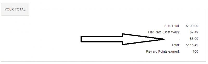

I'm having what I believe is the same problem.
Example:
Product subtotal: $34.00
Shipping (UPS Ground): $13.15
NY State sales tax (4%): $1.89
Ulster county sales tax (4%): $1.89
Total: $51.45
The tax calculations appear correct. $34+$13.15= $47.15 x 4% = $1.89
BUT! when you add $47.15 + 1.89 + 1.89 = $50.93 NOT $51.45
There's a $0.52 discrepancy in the calculated final total. Interestingly enough the shipping amt. $13.15 x 4% = .526
It looks like the local sales tax mod is adding in the tax on the shipping twice, but I can't quite see where that is happening. I'm using the files from 2.5.1 from June that you had sent me.

4 Attachment(s)
Re: Local Sales Tax Mod - Support Thread

Hello Zenners :)
I was hoping someone can help me here or lead me to a page where the solution might be located.
I have installed this module and it works perfectly, except the local tax is not defined as to what the price is on the 'order total'
I have defined that the local tax be 8%.
I buy $100 worth of stuff and the local sales tax is calculated to be $8.
Great so far, however, (as depicted in the photo) there is nothing that let's the user know what the $8 is they are being charged.
How can I define it to be 'Local Sales Tax' instead of the blank that appears there? I'm really a novice here trying to learn to be a zenner :D
Attachment 14399
Any help would be highly appreciated. :cool: thanks

nesum18
Hello Zenners :)
Attachment 14399

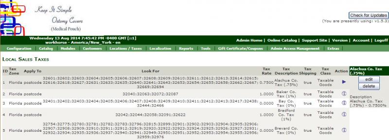

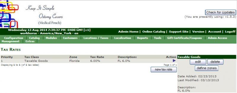

It Looks like you did not completely setup the "Location / Taxes" selections, the information you point to is from these entries, see attached images.
The overall "Tax Rates" Description field is used on the form where you point.
Attachment 14400
If you need to setup "Local Sales Taxes" this next image may help, again the Tax Description field will show on the form in the area you point.
Attachment 14401

THANK YOU SO MUCH! :) Simple solution: I didn't add the Tax Description...lol:D
