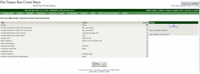

I cannot install the sql patch. I get error msg. WARNING: An Error occurred, please refresh the page and try again. I tried running the different sections individiually and all the other parts ran fine. This is the part it gags on:
Any ideas on how to fix this?Code:INSERT INTO configuration (configuration_id, configuration_title, configuration_key, configuration_value, configuration_description, configuration_group_id, sort_order, date_added, use_function, set_function) VALUES
(NULL, 'Version', 'GOOGLE_PRODUCTS_VERSION', '1.13.0', 'Version Installed:', @configuration_group_id, 0, NOW(), NULL, NULL),
(NULL, 'Debug', 'GOOGLE_PRODUCTS_DEBUG', 'false', 'Turn on simple debug?', @configuration_group_id, 0, NOW(), NULL, 'zen_cfg_select_option(array(\'true\', \'false\'),'),
(NULL, 'Google Merchant Center FTP Username', 'GOOGLE_PRODUCTS_USERNAME', 'ftp_username', 'Enter your Google Merchant Center FTP username', @configuration_group_id, 1, NOW(), NULL, NULL),
(NULL, 'Google Merchant Center FTP Password', 'GOOGLE_PRODUCTS_PASSWORD', 'ftp_password', 'Enter your Google Merchant Center FTP password', @configuration_group_id, 2, NOW(), NULL, NULL),
(NULL, 'Google Merchant Center Server', 'GOOGLE_PRODUCTS_SERVER', 'uploads.google.com', 'Enter froogle server<br />default: hedwig.google.com', @configuration_group_id, 3, NOW(), NULL, NULL),
(NULL, 'Google Merchant Center PASV', 'GOOGLE_PRODUCTS_PASV', 'true', 'Turn PASV mode on or off for FTP upload?', @configuration_group_id, 4, NOW(), NULL, 'zen_cfg_select_option(array(\'true\', \'false\'),'),
(NULL, 'Security Key', 'GOOGLE_PRODUCTS_KEY', @security_key, 'Enter a random string of numbers and characters to ensure only the admin accesses the file', @configuration_group_id, 5, NOW(), NULL, NULL),
(NULL, 'Store Address', 'GOOGLE_PRODUCTS_ADDRESS', 'http://www.domain.com', 'Enter your website address', @configuration_group_id, 6, NOW(), NULL, NULL),
(NULL, 'Store Description', 'GOOGLE_PRODUCTS_DESCRIPTION', '', 'Enter a short description of your store', @configuration_group_id, 7, NOW(), NULL, NULL),
(NULL, 'Output File Name', 'GOOGLE_PRODUCTS_OUTPUT_FILENAME', 'domain', 'Set the name of your froogle output file', @configuration_group_id, 8, NOW(), NULL, NULL),
(NULL, 'Compress Feed File', 'GOOGLE_PRODUCTS_COMPRESS', 'false', 'Compress Google Merchant Center file', @configuration_group_id, 9, NOW(), NULL, 'zen_cfg_select_option(array(\'true\', \'false\'),'),
(NULL, 'Uploaded date', 'GOOGLE_PRODUCTS_UPLOADED_DATE', '', 'Date and time of the last upload', @configuration_group_id, 10, NOW(), NULL, NULL),
(NULL, 'Output Directory', 'GOOGLE_PRODUCTS_DIRECTORY', 'feed/google/', 'Set the name of your froogle output directory', @configuration_group_id, 11, NOW(), NULL, NULL),
(NULL, 'Enable Advanced XML Sanitization', 'GOOGLE_PRODUCTS_XML_SANITIZATION', 'false', 'If weird characters are causing your feed to not validate and you have already ensured your Zen Cart has been properly updated to use the UTF-8 charset, try enabling this option. If this option is already enabled, try disabling it.', @configuration_group_id, 12, NOW(), NULL, 'zen_cfg_select_option(array(\'true\', \'false\'),'),
(NULL, 'Max Execution Time', 'GOOGLE_PRODUCTS_MAX_EXECUTION_TIME', '300', 'Override your PHP configuration by entering a max execution time in seconds for the tool (leave blank to disable):', @configuration_group_id, 13, NOW(), NULL, NULL),
(NULL, 'Memory Limit', 'GOOGLE_PRODUCTS_MEMORY_LIMIT', '128M', 'Override your PHP configuration by entering a memory limit for the tool (i.e. 128M or leave blank to disable):', @configuration_group_id, 14, NOW(), NULL, NULL),
(NULL, 'Max products', 'GOOGLE_PRODUCTS_MAX_PRODUCTS', '0', 'Default = 0 for infinite # of products', @configuration_group_id, 20, NOW(), NULL, NULL),
(NULL, 'Starting Point', 'GOOGLE_PRODUCTS_START_PRODUCTS', '0', 'Start at which entry (not product_id)?<br />Default=0', @configuration_group_id, 21, NOW(), NULL, NULL),
(NULL, 'Included Categories', 'GOOGLE_PRODUCTS_POS_CATEGORIES', '', 'Enter category ids separated by commas <br>(i.e. 1,2,3)<br>Leave blank to allow all categories', @configuration_group_id, 22, NOW(), NULL, NULL),
(NULL, 'Excluded Categories', 'GOOGLE_PRODUCTS_NEG_CATEGORIES', '', 'Enter category ids separated by commas <br>(i.e. 1,2,3)<br>Leave blank to deactivate', @configuration_group_id, 23, NOW(), NULL, NULL),
(NULL, 'Included Manufacturers', 'GOOGLE_PRODUCTS_POS_MANUFACTURERS', '', 'Enter manufacturer ids separated by commas <br>(i.e. 1,2,3)<br>Leave blank to allow all categories', @configuration_group_id, 24, NOW(), NULL, NULL),
(NULL, 'Excluded Manufacturers', 'GOOGLE_PRODUCTS_NEG_MANUFACTURERS', '', 'Enter manufacturer ids separated by commas <br>(i.e. 1,2,3)<br>Leave blank to deactivate', @configuration_group_id, 25, NOW(), NULL, NULL),
(NULL, 'Expiration Date Base', 'GOOGLE_PRODUCTS_EXPIRATION_BASE', 'now', 'Expiration Date Base:<ul><li>now - add Adjust to current date;</li><li>product - add Adjust to product date (max(date_added, last_modified, date_available))</li></ul>', @configuration_group_id, 30, NOW(), NULL, 'zen_cfg_select_option(array(\'now\', \'product\'),'),
(NULL, 'Expiration Date Adjust', 'GOOGLE_PRODUCTS_EXPIRATION_DAYS', '29', 'Expiration Date Adjust in Days', @configuration_group_id, 31, NOW(), NULL, NULL),
(NULL, 'Show Default Currency', 'GOOGLE_PRODUCTS_CURRENCY_DISPLAY', 'true', 'Display Currency', @configuration_group_id, 40, NOW(), NULL, 'zen_cfg_select_option(array(\'true\', \'false\'),'),
(NULL, 'Default Currency', 'GOOGLE_PRODUCTS_CURRENCY', 'USD', 'Select currency', @configuration_group_id, 41, NOW(), NULL, 'google_cfg_pull_down_currencies('),
(NULL, 'Show Offer ID', 'GOOGLE_PRODUCTS_OFFER_ID', 'id', 'A unique alphanumeric identifier for the item - products_id code. ', @configuration_group_id, 42, NOW(), NULL, 'zen_cfg_select_option(array(\'id\', \'model\', \'UPC\', \'ISBN\', \'EAN\', \'false\'),'),
(NULL, 'Shipping Options', 'GOOGLE_PRODUCTS_SHIPPING', '', 'The shipping options available for an item', @configuration_group_id, 46, NOW(), NULL, NULL),
(NULL, 'Default Condition', 'GOOGLE_PRODUCTS_CONDITION', 'new', 'Choose your default condition', @configuration_group_id, 47, NOW(), NULL, 'zen_cfg_select_option(array(\'new\', \'used\', \'refurbished\'),'),
(NULL, 'Condition', 'GOOGLE_PRODUCTS_PRODUCT_CONDITION', 'false', 'If using Numinix Product Fields, include condition?', @configuration_group_id, 48, NOW(), NULL, 'zen_cfg_select_option(array(\'true\', \'false\'),'),
(NULL, 'Default Product Type', 'GOOGLE_PRODUCTS_DEFAULT_PRODUCT_TYPE', '', 'Enter your product type if using default', @configuration_group_id, 49, NOW(), NULL, NULL),
(NULL, 'Product Type', 'GOOGLE_PRODUCTS_PRODUCT_TYPE', 'top', 'Use top-level, bottom-level, full-path, or your default setting as product_type?', @configuration_group_id, 50, NOW(), NULL, 'zen_cfg_select_option(array(\'default\', \'top\', \'bottom\', \'full\'),'),
(NULL, 'Show Feed Language', 'GOOGLE_PRODUCTS_LANGUAGE_DISPLAY', 'false', 'Display Feed Language', @configuration_group_id, 51, NOW(), NULL, 'zen_cfg_select_option(array(\'true\', \'false\'),'),
(NULL, 'Feed Language', 'GOOGLE_PRODUCTS_LANGUAGE', '1', 'Set your feed language (required):', @configuration_group_id, 53, NOW(), NULL, 'google_cfg_pull_down_languages_list('),
(NULL, 'Show Weight', 'GOOGLE_PRODUCTS_WEIGHT', 'false', 'Include products weight?', @configuration_group_id, 53, NOW(), NULL, 'zen_cfg_select_option(array(\'true\', \'false\'),'),
(NULL, 'Weight Units', 'GOOGLE_PRODUCTS_UNITS', 'pounds', 'What unit of weight measure?<br />pounds OR kilograms', @configuration_group_id, 54, NOW(), NULL, 'zen_cfg_select_option(array(\'pounds\', \'kilograms\'),'),
(NULL, 'UPC/ISBN/EAN', 'GOOGLE_PRODUCTS_ASA_UPC', 'false', 'If using Numinix Product Fields, include UPC/ISBN/EAN?', @configuration_group_id, 55, NOW(), NULL, 'zen_cfg_select_option(array(\'true\', \'false\'),'),
(NULL, 'Description 2', 'GOOGLE_PRODUCTS_ASA_DESCRIPTION_2', 'false', 'If using Numinix Product Fields, append description 2 to description?', @configuration_group_id, 56, NOW(), NULL, 'zen_cfg_select_option(array(\'true\', \'false\'),'),
(NULL, 'Use Meta Title', 'GOOGLE_PRODUCTS_META_TITLE', 'false', 'Use meta title as the title if it exists (for products only)?', @configuration_group_id, 57, NOW(), NULL, 'zen_cfg_select_option(array(\'true\', \'false\'),'),
(NULL, 'Enable Map Pricing', 'GOOGLE_PRODUCTS_MAP_PRICING', 'false', 'Enable MAP Pricing (requires separate add-on)?', @configuration_group_id, 58, NOW(), NULL, 'zen_cfg_select_option(array(\'true\', \'false\'),'),
(NULL, 'Use cPath in url', 'GOOGLE_PRODUCTS_USE_CPATH', 'false', 'Use cPath in product info url', @configuration_group_id, 59, NOW(), NULL, 'zen_cfg_select_option(array(\'true\', \'false\'),'),
(NULL, 'Google Product Category Default', 'GOOGLE_PRODUCTS_DEFAULT_PRODUCT_CATEGORY', '', 'Enter a default Google product category from the <a href="http://www.google.com/support/merchants/bin/answer.py?answer=160081" target="_blank">Google Category Taxonomy</a> or leave blank (note: you can override this default setting by creating a Google Product Category attribute as per the documentation):', @configuration_group_id, 60, NOW(), NULL, NULL),

This what my configuration looks like. This does not look complete.
Help!
I would definitely double check the downloaded archive and the presence of ALL the needed files in the website, as a first step, and then at the error logs, to see if something wrong happened on the DB when installing...
I have tried using the unistalsql and I believe the patch is still install because if I try to install I get the error message that there are duplicates. How would I manually remove this patch so that I could start over fresh?
Load a backup copy of the affected tables is the fastest, if it's a SQL issue.
