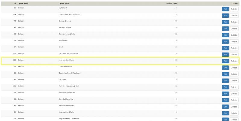

How about posting the 3 lines from the CSV input that resulted in the error messages indicated above?
Re: Simple Instructions for Import
Sure, here is what I have on the csv files. I actually had a few more lines, but I used the first 3 as the others said the same exact thing. Thank you.
Attachment 20943
In case it's hard to zoom, here is copy and paste.
v_products_model v_products_options_type v_products_options_name v_products_options_values_name
cm4850BLK 0 Bedroom Inventory (click here)^Mirror^Base^Top Glass^Stool^Vanity with Stool^Inventory (click here)
cm4850WHT 0 Bedroom Inventory (click here)^Mirror^Base^Top Glass^Stool^Vanity with Stool^Inventory (click here)
cm5264-charcoal 0 Bedroom Queen Bed^King Bed^King/Queen Rails^Queen Headboard / Footboard^King Headboard / Footboard^Inventory (click here)
chuckrey
Attachment 20943

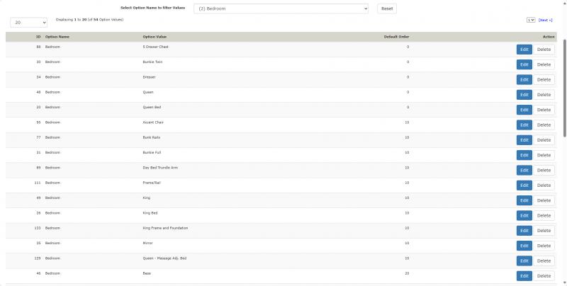

I'm not seeing the "Inventory (click here)" option value listed in the screenshot you'd posted in post 549.
I have multiple pages of Bedroom. It's on page 2. See pic.Attachment 20944

Just an update in effort to have DBIo working for me.. I checked the table products_options_values_to_products_options on another site then extracted the data (the products are the same) I then went to the website where I have DBIo installed for testing purposes and imported the table (this table was empty even after I initially uploaded Option values via DBIo). After the table import via phpMyadmin the fields are displaying within admin. Is there another file within DBIo I am suppose to upload for the products_options_values_to_products_options table to be populated?
chuckrey
Nope, it'll happen 'organically' in the correct DbIoProductsOptionsValuesHandler.
Started fresh once again and downloaded the DBIo plugin w/ the recent changes made in GitHub and so far so good. My final update will be prices to attributes.
Just wanted to provide an update in case anyone else is having a similar issue. The latest GitHub files seemed to help resolve my issue. Thanks!
chuckrey
Thanks for the update! I'll get that updated version packaged up and released.
