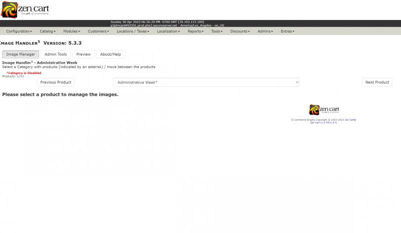

I just upgraded from 5.3.0 to 5.3.3
Not sure what happened or if it was like this before the update but my Image handler page ( Image manager tab) is blank.
Only the category are being displayed. No matter which category i select in the dropdown, it won't move from the first one. There is no product being displayed after that.
Attachment 20274
I uninstall/install the plugin but same thing. Also no error logs are present
