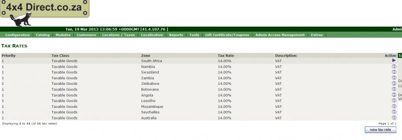

I see when a client who is on the wholesale pricing checks out, the system messes up the tax completely
It show on the invoice zero tax (but tax is set on 14%) then even though it shows zero tax it adds the tax to the product price BUT in the final breakdown only shows tax on the shipment and not the product. But the grand total is correct with tax added.
If I log in with a user who is on the normal pricing then it calculates and displays everything correctly.
I use Zen 1.5.1 and Dual Pricing 2.1
See the two screen shots below:
Attachment 12204
Attachment 12205
