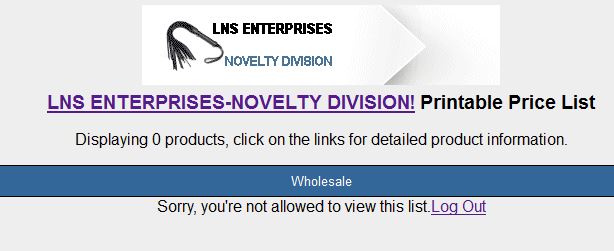

Currently, I have 3 pricing groups...Retail, Associates, and Wholesale. I am wondering if there is a way to make the Price List Profiles match these options? I have also noticed that it always supports/shows the wholesale pricing...this is not good unless you are logged in as a wholesaler...should they not reflect retail pricing unless logged in otherwise?
The other issue I have is when not logged in it shows cant view need to be logged in, yet when I do login, it says I cant view and need to logout....Any ideas?Attachment 12641Attachment 12642
My url for the pricelist is.....http://novelties.lingeriensuch.ca/in...page=pricelist
Tanx so much

This is asking me to login >> /index.php?main_page=pricelist&profile=3

If it's been installed correctly perhaps it was not added to the new admin profiles correctly.
Therefore, you can log in as a Superuser and still see nothing.

The store has been around since v1.3.7 (2007) and progressively updated to 1.5.4
I will pop this into another local 1.5.4 site on the weekend and see what happens.

Installed on another 1.5.4 local site and have no problem running this plugin - so somewhere in the other site something has gone astray..... :rant::frusty:
Let's keep digging....
Re: Printable Price list :: support thread
Perhaps something in a .htaccess file?
Nope, but very close: permissions!!!! :oops:
Worked a treat on the live server, but the live server automatically assigns the correct permissions to folders and files (755 and 644) whereas the local dev server didn't hence the partial blank page.

@frank18, thanks for following up! Was it the permissions on the /includes/templates/template_default/pricelist folder that was giving you grief?
Yes, that was the culprit....
Thanks, frank18! I'll add a note to the top of the plugin's readme to suggest that permissions on that newly-added folder might need to be checked. What are your host's default permissions?

I've submitted v2.0.1 to the plugins' area for review:
- BUGFIX: Corrected the name of /includes/templates/template_default/pricelist/profile-1.css (was proile-1.css).
- BUGFIX: Include missing language /extra_definition files.
- CHANGE: Open pricelist in a new window when Information sidebox link is clicked. Changed /includes/modules/sideboxes/YOUR_TEMPLATE/information.php.
- CHANGE: Add configuration switch to enable/disable display of the currency symbol in the pricelist display's header. Changed /YOUR_ADMIN/includes/functions/extra_functions/init_price_list_admin.php and /includes/templates/template_default/pricelist/tpl_main_page.php.
- CHANGE: Added permissions-check notice to the top of this readme.
That problem happened locally (local Linux dev server on my computer) - entirely my fault. Had to tweak some settings so it does not bugger me again.
On the live server it worked instantly as permissions are automatically assigned to 755 (folders) and 644 (files).
