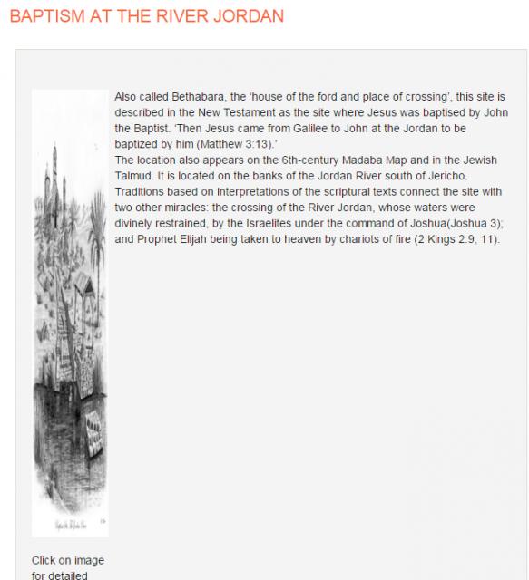

A quick question on the responsive side if I might. On one of my multi sites holyland.artprinthub.com in certain screen sizes and browsers the images are being squashed up. Attachment 15806
What do I need to look for?
