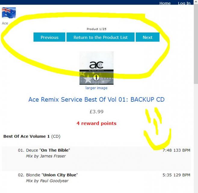

Me again
Since moving to the classic responsive design I've noticed that when on phones, tablets etc the display appears properly BUT on a wide screen monitor (which is pretty standard these days) the horitontal menu gets messed up (see attached iamges).
Any ideas how this can be rectified or which CSS needs to be changed??

Josh4u
Me again

Hi Josh4u
Is this an update to an existing installation?
If so have you tested with a fresh install?
Check your settings in the various "Product listing(s)" for an option for that QTY box.
If you are using the "Buy Now" button. Don't know for sure if you get a QTY box with that setting.
I'm looking at your site on a 1920 X 1200 screen and it looks good.
If you're using a wider screen that take a look in the responsive css files for settings greater than that.

While we're at it I'd like to see if it's possible to move the menu items from the left side of the menu bar to the right side in the responsive classic template. (See attached image)
I have turned off the search function and tried several mods to the css but the menu jumps to the center when you reduce the page width.
Attachment 18064
