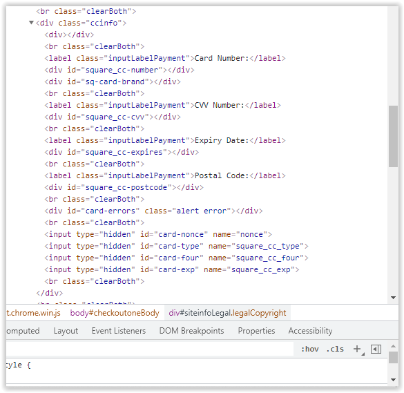

Okay, so first off, I move the site from www.example.com/test to a www.example.com as there were several smaller issues that were driving me nuts. That move solved many of the nagging issues. However, this one is now reproducible at www.wlcartistrydesign.com. I have gone into the Chrome Developer console to get the CC field info AFTER selecting the shipping method. The CC fields were visible (although not in a visually appealing way.) Here is the data in the console for the elements.
Attachment 19652
Notice that all the div IDs have no content...
When I go back and ADD an item, the fields are back...
Attachment 19653
What is going on here?

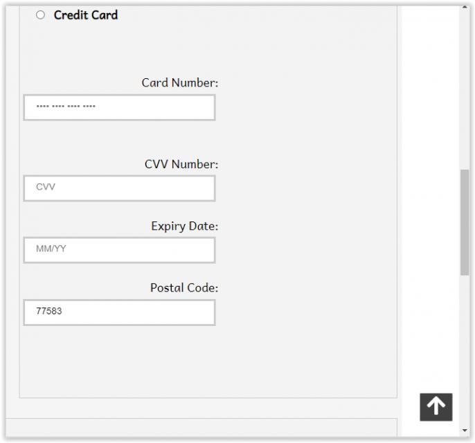

Here is the element details when the fields are visible. Completely different that the first time.
Attachment 19654
