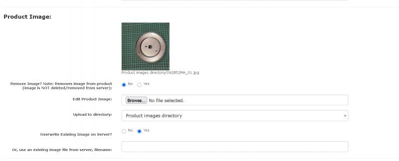

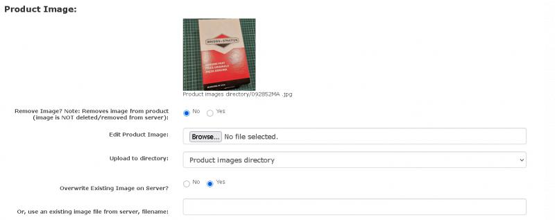

Hi the watermak_LGE is working will just have to resize the other images to suit small and medium I think which I will do shortly.
Last issue is with the additional images which are not showing up anymore for some reason and I thought that it had to do with the code change but after reloading the old file no change so it appears to be not the issue with that.
This is a link to a new products that I listed on the site which is not showing the aditional image:
https://www.outdoorking.com.au/murra...ulley-092852ma
https://www.outdoorking.com.au/brand...ideon-092852ma
The first image that i loaded via Product images directory/092852MA .jpg
Screenshots below:
Attachment 20955
Attachment 20956
Note that I used the 092852MA image on one listing and 092852_01 image on the other listing and I am not sure wether that caused the issue with additional images because after that no additional images are loading for some reason.
As always any help would be appreciated to solve the issue.
Once again any assistance would be a great help to sort the issue out as all the other listings have still got the additional images showing.
I am not getting an error showing in regards to the issue. The only thing that I tried to do is clear the cache and I did get this message saying it could not delete it but for some reason since I have posted the cache was cleared.
