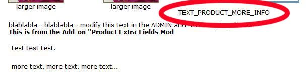

Extra <li> and extra line of text
Delia,
Awesome mod! love it!
I tried Lat9 "update" to get rid of the extra <li> with no luck so i ended removing the <li> straight from the tpl_product_info_display.php.
I still got a small issue:
I got a piece of text saying "TEXT_PRODUCT_MORE_INFO" showing up on top of the extra text field and i can't figure why.
It's probably so obvious that i can't see it :blush:
From the Developers Tool Kit in the Admin, the only place i found "TEXT_PRODUCT_MORE_INFO" is in the tpl_product_info_display.php file:
<div class="files">
<?php if(isset($products_file_1_link) || isset($products_file_2_link) || isset($products_file_3_link) || isset($products_file_4_link) || isset($video_file_link) || isset($extra_field)) {
echo '<div class="filesHead">'.TEXT_PRODUCT_MORE_INFO.'</div><ul>';
How can i get rid of the extra line of text?
Damien
http://i294.photobucket.com/albums/m...ScreenShot.jpg
FYI: I moved the extra.field underneath the additional images, the add to cart button, etc...
Re: Product Extra Fields for text, pdfs and flash
To those who might have the same problem, i found out a solution to my problem posted above:
I simply added a definition to my "product_info.php" (the one in includes/languages/MYTEMPLATE/)
define('TEXT_PRODUCT_MORE_INFO', 'More information: ');
:clap:
Easy enough!
Damien
