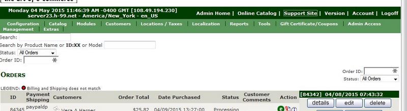

Looking in my admin at the orders page, I've noticed that I now have doubles of some search boxes. Maybe a merge mistake. Can somebody tell me in what files these boxes are? Need to have another look, but otherwise it's working fine now.
Here is a picture of what my orders page looks like with the extra search boxes.
Attachment 15259
just uploaded the orders.php from your github mod and it is still showing as in the pictures. Can you have a look at it?
I think this section is forming all the search fields, but which one creates the double?

No.. That's NOT what I am saying at all.. You need to merge the orders.php file from the mod with your orders.php.. You appear to have added only the part of the changes made.. The double search fields are because you merged in my changes (which modifies the search fields by simply removing the search fields from tables), but DID NOT remove the ORIGINAL parts of the file with the search fields which is why they appear TWICE in your store.. I'm not sure I can explain this any better..
I do get what you are saying but please try and hear me too. Please have a look at YOUR order.php in the zen_COWOA-master on github. The doubles that cause my issue are there. I am testing YOUR un-merged version from the zen_COWOA-master set.
I took the time to try and find the original search code and think this section is it:
again, this is present in your mod. Just thought you might want to fix it on your end as well.PHP Code:
