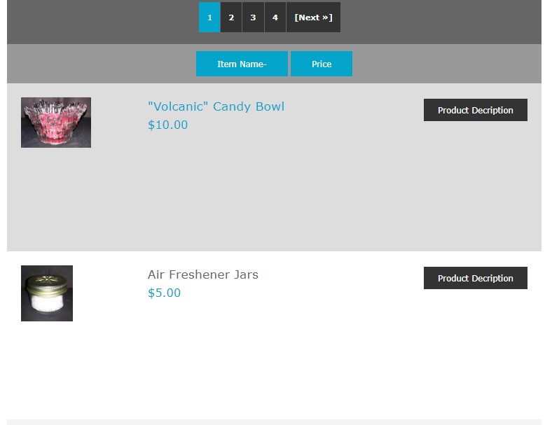

Me again
Since moving to the classic responsive design I've noticed that when on phones, tablets etc the display appears properly BUT on a wide screen monitor (which is pretty standard these days) the horitontal menu gets messed up (see attached iamges).
Any ideas how this can be rectified or which CSS needs to be changed??

Josh4u
Me again
Also has ANYONE found a way to put a quantity box onto the shopping cart in phone/cell mode - the "update button" is shown but no input box to change the quantity???
Thanks in advance :)
Zen Cart 1.5.5f
PHP Version 7.2.10
Database: MySQL 10.0.36-MariaDB-cll-lve
website: forthpalm.com
Attachment 18053
Attachment 18054

Hello all,
Can anyone give me advice on my following three issues?
1: First issue is when looking at the new products list from the ZC main page using responsive classic, the product title description is squashed close together between first and second line.
2: As per the second arrow on the picture. Is there any way to display add to cart next to the product on new products page as opposed to having to add quantity on that page and scroll right to the bottom of the page to add to cart.
3: Item description, bottom arrow on page where it says ....more info. Anyway of increasing description length. (Bare in mind this is on the New Products page.
Thanks for anyone who can help with these minor issues.
Nathan
Attachment 18070
himmon
Hello all,
Nathan
Attachment 18070
1:
Increase the line height in the css for that field.
You may have to experiment a bit to get it the way you want it....
2:
Configuration > New Listing > Display Multiple Products Qty Box Status and Set Button Location
Play around with the adjacent display settings an I think You'll come up with an acceptable solution
3:
"Display Product Description" on the same page. (The default is 150)
The above is relevant to all the product listing screens

The first main one is that on the product page, all the elements of the product are overlapping...
http://craftjam.co.uk/test/index.php...oducts_id=3125
This is also true for the images on the product pages, they overlap the quantity boxes.
How do I alter these?
Also is there a way to remove the quantity boxes on the product page list (not in the actual product page) and the 'add selected to cart' button.
I would like people to have to go into the product to add it to their cart.

Your link looks clean on our end except where PayPal and credit card image overlap with Copyright.
It would be useful to post an Image to illustrate the issue.

Actually an image is seldom if ever helpful when trying to rearrange items on a page. There are so many different combinations that can create the "look". No way we can accurately evaluate them without seeing the code. That's why the posting tips request a link(if possible) be included with each thread or post.
Remember that you have a lot of control in the ADMIN >> Catalog >> Product Types >> Product - General >>then edit layout

The two pages I looked at on the desktop look fine for alignment but do not act responsively. Where did the template estorenow come from? It has no css that "responds" to different size screens.
No, that is the old site which is still live until I get the new one running which is in my test directory.

When you load these product pages, they lode fine, then the products slip down the page.
Anyone know how to fix an image moving down the page after it has loaded?
Also does anyone know why the categories menu on the mobile version would not open so you can see categories? I cannot check how anything looks on a mobile version either because the fold out menu doesn't open

I still cannot duplicate any of the symptoms you are reporting.:(
I used http://craftjam.co.uk/test/index.php...oducts_id=3309
I see some minor screen jumps with changes in screen width, but nothing like what you describe.

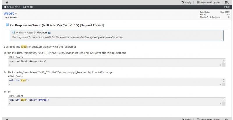

Hard to believe that colors may vary according to screen orientation. Makes no sense whatsoever.
Can't get this to work, but have to tell you and I am a novice at stylesheets, so maybe not making the changes correctly? I am using v1.5.6
<div id="logo" class="centred">
#logo{margin:10px 0;} .centred {text-align:center;}
Hoping this is a simple problem.
I'm a novice too. Perhaps it's just spelling "centered" not "centred"?
Not sure - anyway - here is the original how-to post for centering the Logo:
Attachment 18464
Got it, Mate ! Thanks a million dw08gm - you have "taught a man how to fish".
For you professionals this should be a very easy question. I would like to remove the spacing in between my products:
Attachment 18472
Please make your comments as simple as you can because, I am not very good with programming.
Thank you very much.
