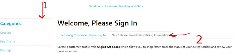

Hi, I have tried everywhere to make these changes and cant figure it out, details in sig.
Have attached a picture as easier for me to explain.
No 1 I want to add -Register after login link so it reads log in - register I also want the shopping cart up there and not as a side box.
No 2 I want to centre the logo, have followed the docs section but have managed to change it but cannot centre it.
No 3 I want to remove this bar and the home link etc completely. I can change the colours but it isnt needed for me.
Any directions would be great

1. To change the wording of the "Login" link to "Login - Register", you'll make a template-override version of /includes/languages/english/header.php (i.e. copy that file to your current template's /includes/languages/english/YOUR_TEMPLATE) and edit the define statement for HEADER_TITLE_LOGIN. The shopping-cart link will show once a customer has placed an item into their cart.
2. You'll need to edit your current template's /templates/tpl_index_default.php, changing the line that reads

Thank you Lat9,
Number 1 worked and number 3, but number 2 centred the picture and not the logo.
For number 3 I want to remove it as the home page link is there at the top, there is a page title already and on my screen thats in great big black letters its just really busy.
Would you have any idea why the logo won't centre?
To center that logo, you'll need to edit /includes/templates/clone/common/tpl_header.php, changing this block

Thank you that has worked :)
It is alot of years since have done any of this and Bootstrap is totally new to me so thank you for your patience. I love how it is easier to alter the template, but some things just loose me so there may be well be, well probably will be a few more questions

I have screen shot where the changes I want to make are and numbered them
1 How do I change the colour of the line going round the categories links?
2 How do I change the wording from "New? Please provide your billing information"
Attachment 20014
I will let others talk about how to change the color of the box (I am sure its in a CSS file somewhere unless they linked it to an admin setting)
As for the text... in your admin, go to the Developer's toolkit and search for that phrase. That will tell you which file has the text string. This could need to be repeated if you use multiple languages.
Thank you will go look there as have spent days looking in my filess in file manager with no luck. Have tried going through the colours on ZCA Bootstrap Colors and cant find how to do the colour change.
g2ktcf Thank you that worked for number 2 will look at the toolkit in future as totally forgot about that.
