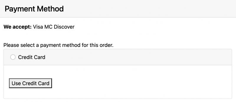

I saw some mentioned of the radio button earlier in this threads.
It does get "selected" once customer fills in their credit card info.
I don't think it will be an issue. Just impatient customer trying to checkout too fast.
Thank you for clarifying it

This is the problem:
Payment Method
Sorry, we are not accepting payments from your region at this time.
Please contact us for alternate arrangements.
you have a country or currency miss match within your setting ether in ZC or at square they all need to match.

Re: Square WebPay support thread.
OJ_SIMON
BAM!!! THAT DID IT! Thanks so so so much for your help! I had the payment zone in ZC as 'United States'.

I'm also having issues. Not having any luck getting the module to go in Zencart v2.0.1. I can't get the module authorized to my Square account. I have the OAuth Redirect URL correct... I'm putting in the correct Application ID and application Secret... If I try Sandbox mode I get a yello light for the module (not Green)... and if I click to edit the info I lose the module (screen goes blank and I have to delete the module and re-install it... If I use the production mode OAuth I get HTTP 500 error codes... says my domain cannot handle the request...
Any info on why and/or what I may be doing wrong greatly appreciated... I'm totally self taught with all this website and FTP and everything so laymean's terms work best with me... I don't understand some of the geek-speak termonolgy for these things :blink:
Re: Square WebPay
I'm using Brave Broswer... get the same results whith sheilds (ad blocker) off...cleared the cache/cookis off... have flushed the DNS on my winodws machine... at a loss at what else may couse any issues with the authorization process...
Re: Square WebPay
BigB
Try using Chrome or FireFox. I use Brave and occasionally have problems with websites not working correctly.
Re: Square WebPay
OK, 'll try firefox and see what happens...
Re: Square WebPay
Tried it with FireFox... I get redirected back to my ZC install ######## he screen is entirely blank (white)... still not able to authorize the module :lamo:
