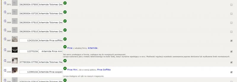

Product description with link inside
Zen Cart 1.5.5e
I found the problem with products description, while there is link inside. Part of the description is visible on main page - please have a look at the screen attachedAttachment 17849.
Meksicus
