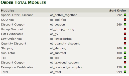

This was originally posted in 'Built-in Shipping and Payment modules' but kobra suggested I move it here.
I am on ZC 1.5.4 using the Better Together 2.5.1 mod and the built-in ZC Authorize.net (AIM) payment module.
I have a Better Together deal defined so if a customer purchases item A, they receive a $1.00 discount off as many of item B as they want to purchase. Recently, a customer purchased item A and 10 of item B which should have given a total discount of 10x$1.00=$10.00. The appropriate discount was reflected in the shopping cart and on the completed order in ZC, but the amount charged to the customer's credit card did not reflect the discount. My order total modules are shown below. I checked my error logs and found nothing there that indicated a problem. What could be causing this error?

One more key detail. The error occurred with the first (and only) customer who used the coupon. This isn't something that worked previously, but now doesn't.
Re: Better Together Contribution Support Thread
What coupon would that be?
What does the second sentence of your last post mean? You surely mistyped something.
Can you reproduce this problem? I have never heard of an interoperability issue between Better Together and AIM.
The coupon with the issue is described in my previous post (#638). I did call it a 'deal' in that post, though, which is the correct term. :smile:

As I am testing an upgrade from 1.5.0 to 1.5.5, I don't have this mod installed, or at least I don't need it (the products I was using it on are becoming obsolete). Now, in my test upgrade, it is using the DB from the live store. When testing a transaction, I get the message that it is looking for the ot_better_together.php file. Now, it is obviously not there, but I am wondering where it refers to it, so I can remove that reference. Or should I install it and not use it?
You should install it and use it. :)
J/K. Install it, then go to admin-modules-order total-better together, and press the remove button. There are probably lingering database entries that you can delete by doing this.
It's a database setting. You probably have to remove and re-install under Admin > Modules > Order Total.
