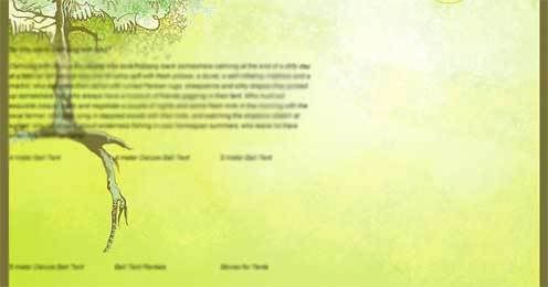

Hi there this is a great module and I just wanted to say thanks for it.
I think im pretty much there but my second site is not receiving any content to show, and also doest get the menu or a side box.
I have added all categories to both sites, and the 1st site works very well, its just the second doesnt seem to get past loading the background image.
I have taken a screenshot which im sure some guru will look at it and say you have forgetton to do x, and it will all be solved. (or at least thats what im hoping for).

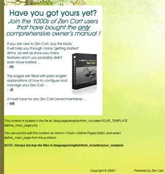

Re: MultiSite Module Support Thread
I have half sorted it out, after making a stupid mistake, I didn't upload the correct /languages/english/html_includes/cws files.
I am now getting the main page text but its not being formatted by the css, and is all starting from the left border of the background image.
I get a few produces listed on the screen, but no images are coming up for them, and still no side box.
