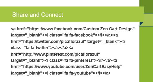

Hi Anne
Weird thing has happened. I went into the footer options through admin and removed 1 line from it and now at the bottom of my page I have this ...
Attachment 16162
So immediately I thought I had removed something I shouldn`t so I used the code from a working site and still nothing. So I went to a third site that's working and removed 1 line and got the same that's in the picture, I put the original code back and again it didn`t work. I'm baffled as I have put it back to how it was originally but it will not work.
The error is on a clean zencart install using the Sheffield Blue theme.
Do you have any idea what is wrong, I have not deleted, renamed or changed anything other than that code in the footer option from the admin panel.

MCS_Computers
Hi Anne
Attachment 16162
Try removing the code in admin--tools--flexible footer menu for the icons and replacing it with this:
<a href="https://www.facebook.com/Custom.Zen.Cart.Design" target="_blank"><i class="fa fa-facebook"></i></a><a href="https://twitter.com/picaflorazul" target="_blank"><i class="fa fa-twitter"></i></a><a href="http://www.pinterest.com/picaflorazul" target="_blank"><i class="fa fa-pinterest"></i></a><a href="https://www.youtube.com/user/ZenCartEasyHelp" target="_blank"><i class="fa fa-youtube"></i></a><a href="" target="_blank"><i class="fa fa-instagram"></i></a>
