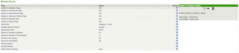

I had Dynamic Filter installed for years, and when I switched to a new template it stop working, by this I mean, it's not responding to admin settings, for instance under my main categories, it's listing all the products, instead of filtering just a few, as it supposes to do
Of course this is just an excerpt as I don't want to show more than 11000 links here, as a few suffices ... as an example, but my point is why is this huge list in the source code, even when my settings are these? >>>HTML Code:<span>Shop</span>

To my understanding the limit should be 15 links, and not all 11,000+ as it's the case now ...
