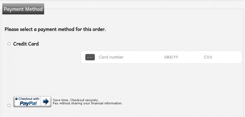

The security problem is fixed but I still don't have a credit card button for the square module. I only have the PayPal button.
Re: Square Payment Module for Zen Cart [Support Thread]
You might want to clear your cache and look again.
Attachment 20205
Got it Thanks!
