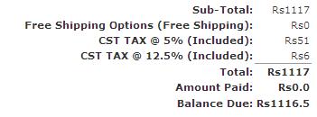

I am currently struggling on displaying decimal places on Sub Total Array in Super Invoice. I am attaching a screenshot for it for reference.
Attachment 10414
I need to show Tax line and Sub totals upto 1 to 2 decimal places.
Please help me know how I can do it.
Rest all prices are correctly displaying to decimal places using Admin settings.
Please someone help me...I need to show totals array by 2 decimal places.
All sample invoices for others are showing by two decimal places, but mine s only limited to zero decimal place.
Please guide me how to correct it.
