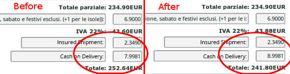

unfortunately, I'm still not so familiar with Zencart. Please, can you give me some more details? A have a problem with the price only when I try to change an order. I uploaded an image that shows you the difference of prices when I change "Cash on Delivery" from 7,9981 to 8,9981 (the same thing changing Insured Shipping). I think the field "ot_cod_fee" is not calculated. I also noticed that Zen Cart properly calculates the order without Edit order. If you need, I can attach the "log" created by edit orders.

lhungil has already answered your question, but let me try and re-phrasing it.
The issue is not with Edit Orders, the issue is with the Insured Shipment and Cash on Delivery order total modules.
Insured Shipment and Cash on Delivery are not correctly re-calculating the COD or Insured Shipment totals when you edit the order using Edit Orders.
Again.. This is not an issue with Edit Orders, this is an issue with your two order total modules (Insured Shipment and Cash on Delivery
Installed order total modules are responsible for returning the correct data when an order is edited. Insured Shipment and Cash on Delivery are not working when loaded from the Zen Cart administration interface, and therefore they will not work with Edit Orders. Do you have any related Zen Cart logs? If so you should post them..

Changes to the order total are calculated by individual Order Total Modules (and displayed / stored in the database by "ot_total"), not Edit Orders. This means when a third party Order Total module fails to return valid data or update $order->info['total'] as needed... The total for the order will not be updated.
The most common cause of issues reported regarding the total not being correct are Order Total modules not designed as "Standalone", but instead depending upon other modifications to the Zen Cart store front. The modifications needed to Zen Cart administrative interface (for these modules to work) are often not provided to end users. Edit Orders is an administrative tool (run from the Zen Cart administrative interface), so when run these third party Order Total modules do not function as expected or in some cases outright crash.
Another common cause is the third party Order Total module always recalculating (and not using the value from the database). Currently this can be addressed by the third party order total looking at the Global variable $order->totals at the start of the Order Total module's "process" function (or checking the database manually). When the value has been altered via Edit Orders, the altered value will be present (while the "process" function is being called).
