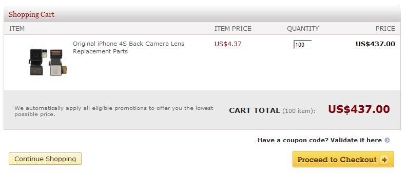

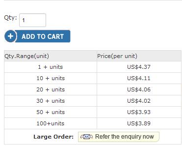

In our store, we offer quantity discounts on all products dependent on the quantity purchased (set in Categories Quantities Discounts ).
The price is discounted correctly in the Quantity Box on the product page. But my only issue is that it's not discounted in the cart. Please refer to the following picture:
Attachment 13369
Attachment 13370
The cart calculation is just based on base price, but not on discount price. I wonder if it has something to do with the cart and checkout calculating the discount differently?

@Eric, this is the support thread for my Quantity Discounts mod
http://www.zen-cart.com/downloads.php?do=file&id=135
which is different from Numinix's mod
http://www.zen-cart.com/downloads.php?do=file&id=1485
And it appears you are using his rather than mine.
In any event, both are order total modules, which means the customer doesn't see the discount until they check out.
