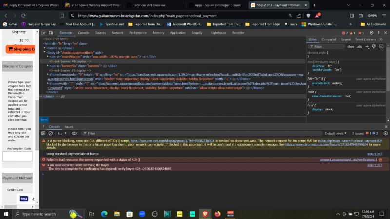

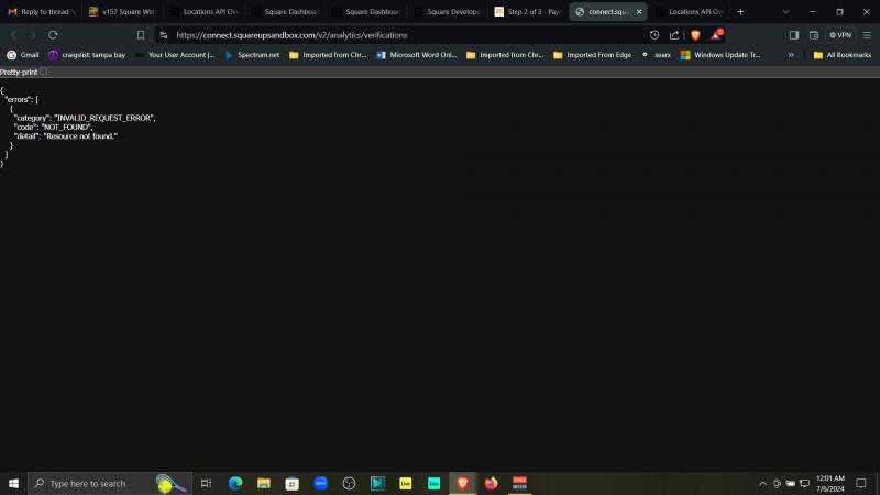

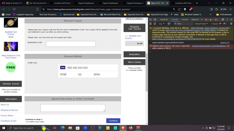

Checkout still hangs at Step 2 of 3... screenshot attached... same error 400
Attachment 20693Attachment 20694
More Console info FWIW...
index.php?main_page=checkout_payment:824 A parser-blocking, cross site (i.e. different eTLD+1) script, https://pan.zen-cart.com/display/gro...rd=55682736003, is invoked via document.write. The network request for this script MAY be blocked by the browser in this or a future page load due to poor network connectivity. If blocked in this page load, it will be confirmed in a subsequent console message. See https://www.chromestatus.com/feature/5718547946799104 for more details.
square.js:3 using standard paymentSubmit button
connect.squareupsand…ics/verifications:1
Failed to load resource: the server responded with a status of 400 ()
square.js:3 An issue occurred while verifying the buyer
The time to complete the verification has expired: verify-buyer-892-12956.874308824885
