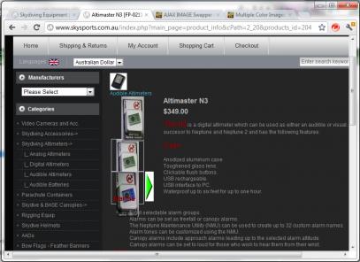

Multiple images displayed one below the other v1.3.9h
Hi, I can't seem to find in this thread a resolution to my problem.
As you can see in the screenshot, I am getting multiple images overlapped one under the other
Attachment 10732
Really don't know what the problem is.
Please help
Re: Multiple images displayed one below the other v1.3.9h
Can't say for sure if the custom template is messing with this.
You need to adjust the height and width for the id's image_viewer and image_medium_container until it looks like you want it. You can see the values if you use the firebug addon with Firefox.
