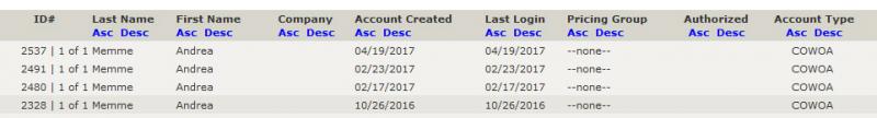

We have a one time use per customer coupon we offer to first time buyers. Unfortunately, we have a customer that has been using COWOA and has been able to reuse the coupon every single time she checks out. I looked at the customer list and it looks like she is getting assigned a new ID # every time she shops even though she is using the same billing/shipping/email address.
Attachment 17037
Is there a way to get around the cart treating her like a new customer every time she uses COWOA?
We are using Zen Cart 1.5.4 and COWOA 2.4
