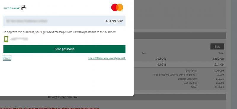

Thank you for this information. It is interesting that ZC leaves totalling of the order (in part) to the payment module... I can, I think, now comprehend the scale of the issue!
What is strange to me is that the bank actually processes the discounted amount despite the original request for the customer to approve (via the 3D pop-up screen) being the pre-discount amount. Where does the information for that initial bank response originate? - that is not used subsequently.

Hi carlwhat
Very many thanks.
I reviewed the ogg files and noticed that you used the standard zc checkout. I mentioned, in the beginning, that I was using OPC. So I thought, what if...I switch off OPC?
It works. Proper amount used in the bank pop-up matching the discounted amount etc.
So, I guess I now need to see what OPC is doing. So your suggestion that a modification is at play was correct. It would appear that One Page Checkout doesn't quite link to the Square Webpay payment module in the same way as the standard 3 page checkout!
