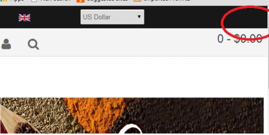

Thanks for the reply. Yes, the search box comes up in the mobile. But the top right menu has somehow disappeared and I have nothing to tap and go ahead. Attaching as below. Also, there is blank space on the mobile between the top navigation bar and the slideshow.

Now for menu button that is supposed to be in the upper right corner I see where the problem is as the menu is actually being forced above the screen view. This is because you have now moved the slimmenu up and taking away the top-wrapper section. So to fix this, it will be a multiple part process as you will have to change each instance the menu should appear correctly in each screen size view. To get you started, this is what you want to look for:
In your responsive_default.css file, you will see it broken into multiple sections of media queries for different screen size layout. In this example, look for the start of this section: "@media (max-width:767px){" and then below it in that section look for:
change to:Code:#menu {margin-top:-130px;width:98%;}
This will fix the layout for this size view only. Just go through all the changes in each css file, there are 3 of them which needs to be done for mobile, tablet and default desktop view. Just look for the "#menu" element and change the margin-top value.Code:#menu {margin-top:-5px;width:98%;}
Another thing is that you do have another change in that you have 2 flexsliders present on tablet view. You seemed to clone the code in the main page file and pasted it in the header file. Go back and delete the one in the header file as it is causing alignment issues.
And one last thing I will comment on. The handheld mobile section your moved up is actually suppose to be contained in a max-width which is set stock at 1230px. But since you did remove a whole bunch of code that was not really apart of the logo section, you now have a menu that is full screen. So those with wide monitors will actually be hindered at your coding as the menu would be extremely small and spread out. To fix that, put back the first part snippets of the class one-row fluid. It is this part:
