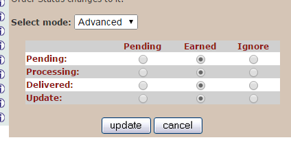

So right now I have them marked like this
Attachment 15190
and it isn't working. Should I have them marked in the other column? I think I've tried both and it didn't work for either one.
Attachment 15190
bumping this to see if I can get some help. It is still not working for me? See post above.

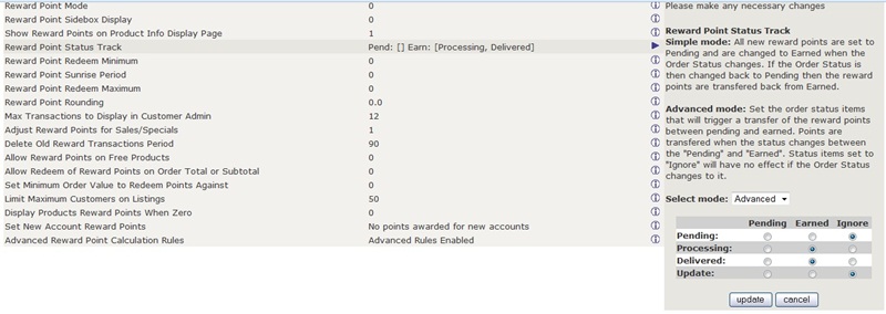

On a stock zen cart 1.5.4 with reward points installed. This is how I have the reward points configuration setup.
Attachment 15202
The points transfer just fine from pending to earned when changing order status from processing or Delivered. Go back check your installation all I can tell you.
K, I changed to match yours. I'll see if that works. If not, I'll try installing it again myself and see if maybe he missed a file. Do you have any idea which file controls that so I can maybe just check that one?
Still not transferring for me. I downloaded the module again and checked all of the files that were installed back in February and it appears they are all there where they are supposed to be. I did notice this though. Do you think the one that is highlighted in blue may be causing a conflict? Can I delete it?

I have reinstalled and made sure my screen matches yours on advanced and it is still not working. I'm still having to transfer points manually.
