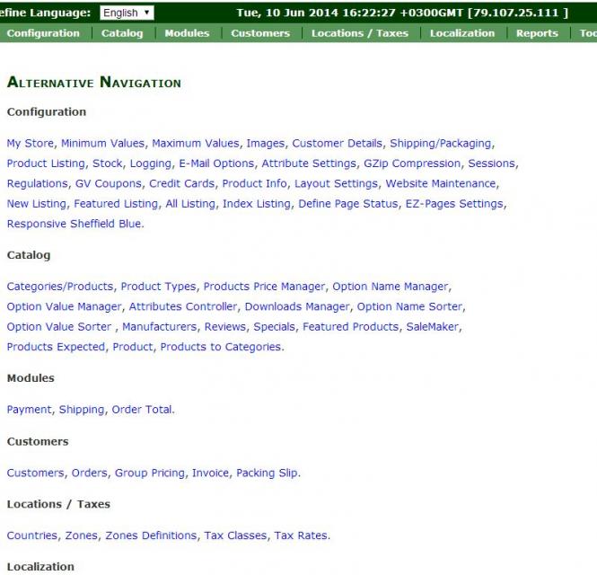

Hello
I have this site under construction
http://sptech.gr/zencart/index.php
1. I have problem in this 2 pages
http://sptech.gr/zencart/index.php?m...=1&language=el
http://sptech.gr/zencart/index.php?m...=1&language=en
The English version is ok. What is going on with Greek??
2. In admin section in Greek language i don have all the attributes as i have in English as show in attached pictures
Attachment 14155
Attachment 14156
Thanks George

Re: Brands not showing up in drop down menu
George Zacharopoulos
English is the only language included in the template package. If you want to use the template in another language you will need to copy all template language files to your language and then translate them.
Hello
Thanks George
The problem was "user agent stylesheet" I put in stylesheet "table {font-size:1em}" and everything is ok.
What happens in admin section? I look all the directories to check for Greek files but the problem still exist
Thanks George
Thanks George
I have no idea what you are talking about. The template only comes with english installed. If you want to use it with another language, you need to copy all of the template language files to your language and then translate them.
