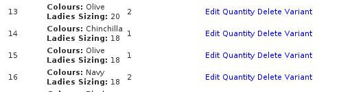

My query; the sort order of the information generated. Many people have pointed out that the reporting of sub attribute numbers is not hierarchal.
eg you can get a situation like this
Attachment 6624
In this example it would make more sense for the data to be organised by size and then colour
I understand that the sort order is not manipulated by the contribution so the order should be inherited from Option Names and Option Values.
Problem - no matter how many times I change the sort order of these items and update through the Store Manager, the contribution refuses to change the original order (as per the example)
When I start to dig around in the files in Admin (admin/includes/classes/products_with_attributes_stock.php) I see there is a whole lot of data that is hard ordered
Can anyone guide me on this please - ie how do I influence the sort order without tampering with the contribution
