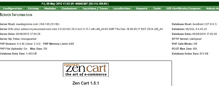

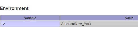

Host server was recently upgraded with timezone set to UTC. Since my local timezone differs, I attempted to implement this workaround. Completed step1, as instructed, changing TZ to my local timezone. Checked admin banner, but it still shows as UTC value. Now what? I have attached screenshots showing banner, PHP date values, and added TZ value.
