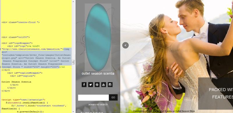

Thanks however I am now checking the mobile.css, to see if I can fix the elongated logo .... hmmm really weird but I tried to change the div height from auto to a fixed pixel size and didn't work ...
Still clueless about how to fix this >>>
A screenshot from Dreamweaver's CS6 live mode, which shows exactly what happens with my iPhone 4 ...
Attachment 14355
Attachment 14355
What is the link to your site?
