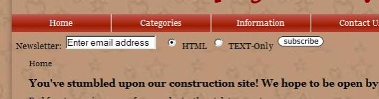

I put the subscribe field on the bottom of my header. It looks fine in IE7, like thisAttachment 6010
which I want.

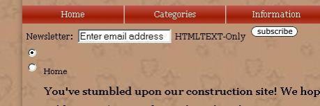

In FF and IE8 it looks like thisAttachment 6011
which I don't want, after all it's kinda broken.
I'm pretty sure the solution lies in my tpl_subscribe_header.php file.
I found a post in this thread that had a modified version of this file that made it look like thisAttachment 6012
which isn't broken, but I wanted it inline so that it doesn't use up the extra vertical space.
I played around with the a-fore mentioned file for a couple of hours (refering to some php tutorials along the way) hoping to fix it myself and learn a bit in the process, but I must admit defeat.
If anyone can help it would be much appreciated.

Thank you for your second suggestion Nagel, but unfortunately that didn't work either.... Do you have any other ideas or suggestions? And any idea why "maintenanceDefault" is called in the tpl_subscribe_default.php and tpl_subscribe_confirm_default.php pages? Thanks again!
Don't know why it is called, but afaik it shouldn't really matter what div is called as long at it is loaded and declared as you want it...
Wish i had more css skills to help you out with but i am afraid it is as much trial and error for me as it is for you from here on in.
Jeroen
different browsers can be frustrating, which is probably why i abandoned the whole header option completely.
Maybe you should consider putting a link in or around that space (or even a button) that says subcribe to newsletter, and link that to the newsletter_subscribe page.
you can also add a sidebox if that fits your site layout so you have another eye-catcher for people to subscribe.
good luck,
jeroen
