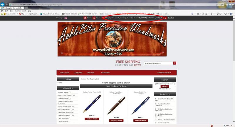

Header displaying code rather than name, link still works.
I have just undergone a system upgrade from Ubuntu Server 12.04 LTS to 14.04 LTS with Apache 2.4. Everything works as it should, however, looking at the attached image, you will see that the link in the header displays code instead of simply displaying the link to the shopping cart. I looked at the file and confirmed that nothing within it had changed. In 12.04, everything displayed correctly. I am using the same database and files as were on the 12.04 installation with no changes. I have a feeling it may be one more of the little changes within Apache since I installed opn my 12.04 system 3 years ago, but am not sure. Any suggestions would be greatly appreciated. AS stated in the subject, the link to the cart works as it should, but the code being displayed is an issue that I need resolved as I know it will make customers nervous. Thanks in advance!

This is because there are php short codes used. I have already posted a fix several times for this ;) You can also see this:
http://www.zen-cart.com/showthread.p...02#post1141102
