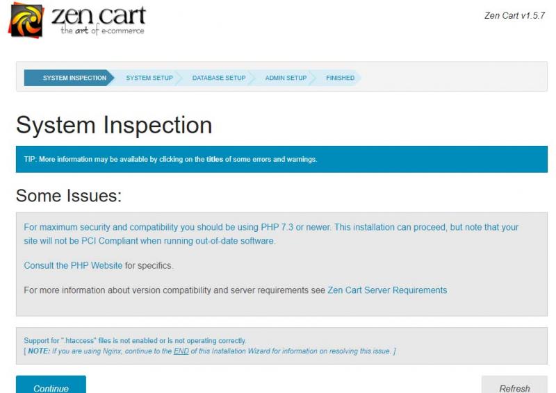

Re: Support for ".htaccess" files is not enabled or is not operating correctly.
Here is a screen shot:
Attachment 19125
Ya, you probably didn't upload the .htaccess files that exist in the various subdirectories.

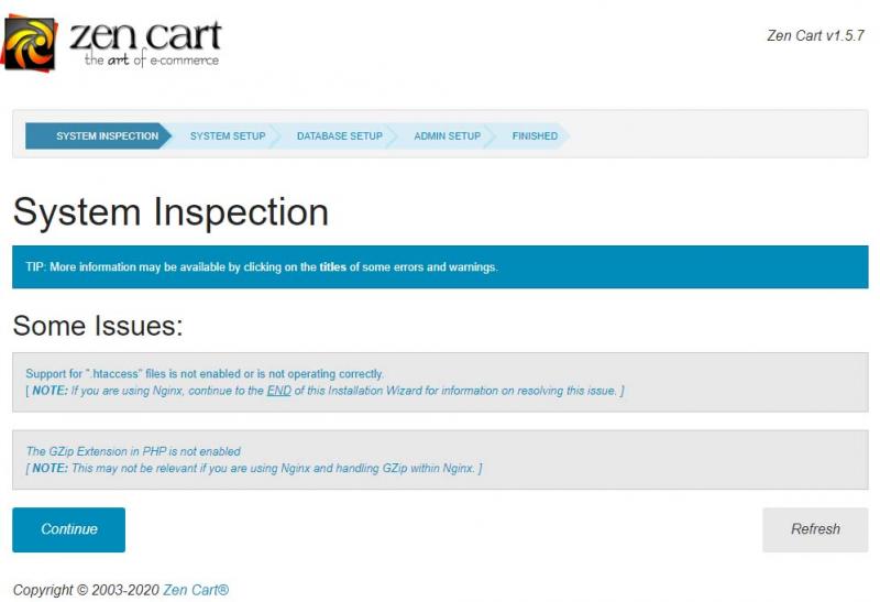

There was no htaccess file in the new subdirectory folder for my new version and I had to tell my host to upgrade the PHP to 7.3 for that folder as my current running version broke with newer php. Host tech support enabled the 7.3 on the new site folder and added an .htaccess file. The php error went away but the ones in my screen shot didn't. I just deleted the .htaccess file and the 7.3 error returned. I'm lost.
Attachment 19126
Part of the problem may be the PHP level of the older version of Zen Cart.
If you are trying to run two PHP levels that are not compliant with BOTH versions of Zen Cart, it will not work if the carts are at the same level.
Your older cart probably has the .htaccess file because your cPanel set the file either through cPanel's setting the PHP, setting a 301 redirect, or both. Most cPanel-created .htaccess files are to set the PHP for that folder. Here's an example of both.

This makes sure that, no matter if http or www is used, all requests for the domain wind up at htps://YOURDOMAIN.com and sets the PHP level at 7.2 Other than providing a PHP level for the folder, this .htaccess is, as DrByte says, not required for Zen Cart.
Let's say the older version is in public_html (aka the root) and the PHP is 5.6.4. Nothing you or the host does will "allow" a higher PHP on another folder at the same level. Normally, a site is at "home/public_html". If you move your 1.5.7 folder to "home/", you can then set the 1.5.7 folder to the 7.3 and it will "take". This will allow you to finalize 1.5.7 while ensuring that your older site will be working as well.
