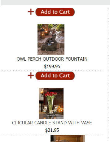

I just installed this on ZC 1.5 and while it work, I seem to be having the same issue as others here. The BUY NOW button shows up above the product image/description etc. Sold out products show up with a Sold Out image but with a " > " symbol after the image. Are other folks having the same issue please share how they resolved it?Attachment 10440
Re: Buy now button in main page products
kman55
Attachment 10440
Not sure if people are still looking for a solution. I have v1.5 installed from new. No mods, just a new template.
Try this, it works for me:
$specials_index->fields['products_name'] = zen_get_products_name($specials_index->fields['products_id']);
$list_box_contents[$row][$col] = array('params' => 'class="centerBoxContentsSpecials centeredContent back"' . ' ' . 'style="width:' . $col_width . '%;"','text' => (($specials_index->fields['products_image'] == '' and PRODUCTS_IMAGE_NO_IMAGE_STATUS == 0) ? '' : '<a href="' . zen_href_link(zen_get_info_page($specials_index->fields['products_id']), 'cPath=' . $productsInCategory[$specials_index->fields['products_id']] . '&products_id=' . (int)$specials_index->fields['products_id']) . '">' . zen_image(DIR_WS_IMAGES . $specials_index->fields['products_image'], $specials_index->fields['products_name'], SMALL_IMAGE_WIDTH, SMALL_IMAGE_HEIGHT) . '</a><br />') . '<a href="' . zen_href_link(zen_get_info_page($specials_index->fields['products_id']), 'cPath=' . $productsInCategory[$specials_index->fields['products_id']] . '&products_id=' . $specials_index->fields['products_id']) . '">' . $specials_index->fields['products_name'] . '</a><br />' . $products_price);
Buy now is below everything now. But, I would like to put a quantity inbox too just above buy now button. Any ideas?

I am still trying to figure out. I am trying to get my Add to Cart button at the very bottom under the price. No luck yet. Anyone?
Attachment 15929
