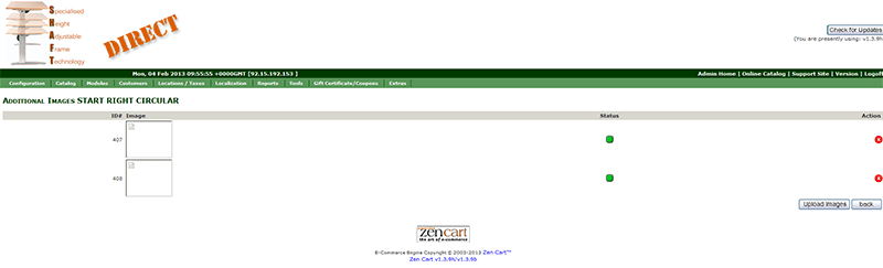

I have installed this mod and it works correctly however, in the title of the admin page 'catalog>Additional Product Images' I see the following headers
TABLE_HEADING_ID TEXT_PRODUCTS_IMAGE TABLE_HEADING_ACTION
Also in the list of products under the category the header is displayed as TEXT_ADDITIONAL_IMAGES
I am running version v1.3.9g
Any pointers would help please :o)
Re: Additional Product Images addon
You are missing several define statements, and probably one or more language files where the defines happen. Check that all of the mod's files were uploaded correctly.

Hi Could anyone help? I am using ZenCart 1.3.9h. Everything was working ok and the product images are showing up, but when I go to upload images, the thumbnails are not clear.
Attachment 11886
When I look at the thumbnail images are simply reading: images/additional/Red-1.jpg and no URL.
Please help. Where can I change this setting? I get the same problem trying to view the Online Catalog link form the Admin panel.
dharrison
The images shouldn't need a URL if a relative path is supplied.
Sounds like your admin configure.php file has invalid HTTP_CATALOG_SERVER, HTTPS_CATALOG_SERVER, DIR_WS_CATALOG, DIR_WS_HTTPS_CATALOG and DIR_FS_CATALOG settings.

Fatal bug found: I installed this addon, but it does not worked. I have Zen Cart version 1.5.5. Error was in database. "Field 'category_id' doesn't have a default value". I changed it to null and now it works. Went many days to find the fault because Zen Card does not display error messages.
juvar
Mind identifying under what server configuration this issue was found?
Note, the category_id field doesn't even appear to be used; however, it does appear that it may have been added to possibly include the ability to add additional images to a category view. If so, that code didn't make it into the distribution.
As to the lack of "display" of error logs, that is correct error logs are not displayed by a vanilla install of Zen Cart, though if they are being generated they can be made available in the admin by the plugin display logs or can be seen by ftp to the server and review of the logs folder. If they are not being generated, then recommend beginning a new thread as that issue is not pertinent to this plugin.

That is good to know. Thanks. Server information:
Apache Version: 2.4.37
PHP Version: 7.2.14
MySQL Version: 5.6.41
Architecture: x86_64
Operating System: linux
This is not only bug that needs to solve because this addon does not work at all. Second fatal bug is in additional_products_image.php on line 82. This line is wrong:
echo zen_draw_products_pull_down('products_id', 'size="10"', '', true, $_GET['products_filter'], true, true);
For some unknown reason there is extra parameters and that is why it does not render at all. It needs to be like this:
echo zen_draw_products_pull_down('products_id','',$_GET['products_filter']);
Here is reference for that:
https://www.zen-cart.com/docs/phpdoc...ucts_pull_down
Now I continue hard work and try to get my Zen Cart to work. This seems to be a part of normal workflow with Zen Cart. It is very buggy software... Anything does not work as expected. Good side is that it's easy to edit source code.
juvar
PHP Version: 7.2.14
You might want to check your software installation as the file admin/additional_product_images.php uses the admin function zen_draw_products_pull_down that is located in admin/includes/functions/general.php which is defined as:
zen_draw_products_pull_down($name, $parameters = '', $exclude = '', $show_id = false, $set_selected = false, $show_model = false, $show_current_category = false) {
Don't know why it has been modified in your admin side.
Also, extra parameters do not cause a function to fail, having the wrong parameters lined up to the wrong inputs can cause a problem.
