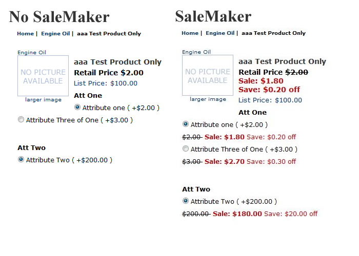

I WIN...
Attachment 13587
2 weeks of my life I'll never get back...
SaleMaker by Attribute - also works seamlessly with Twitch Wholesale + Attributes.
I'm compiling the install instructions and will submit the package as a plugin to ZenCart and I'll make it available on my site.

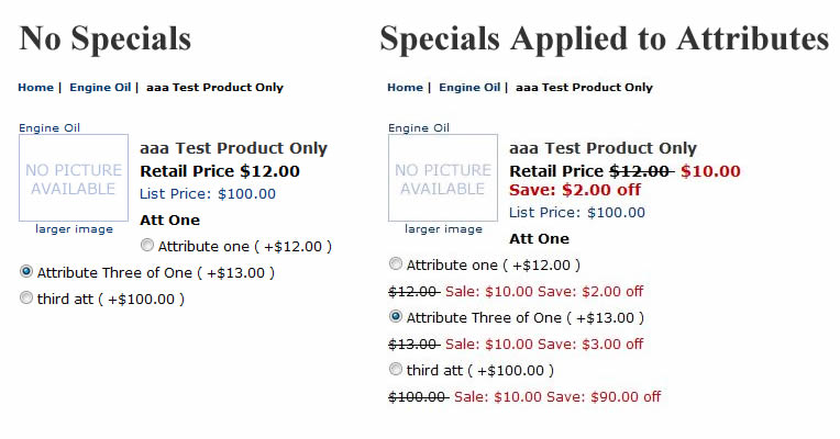

Another day and... Specials by Attribute is now working!
Attachment 13591
SaleMaker does work with Specials when the selected condition is: 'Ignore Sale Condition - No Sale Applied When Special Exists'

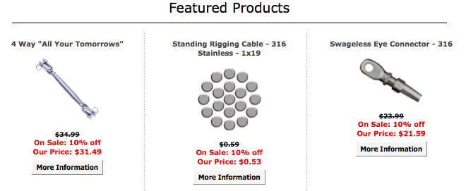

It looks great, but one question. I just got my look reversed re sale and save, so that original price crossed out, then save, then our price or sale price. Attached photo for clarity.
Attachment 13592
Would be great to have knowledge of how to reverse it to that, since that is how the mind contemplates the sale. I want to see the savings, but the last thing they look at, should it be the savings, or the bottom line? Just a nobody's two cents. Appreciate the time spent and effort all zencart builders have made. If I could get profiting, I will definitely make some donations.
Thanks again for your effort.
Marc
