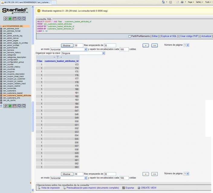

Could you add the three Products to your customer basket then go to phpMyAdmin and browse the table customers_basket_attributes and look to see how those attributes are stored?
Do they all have the field products_options_sort_order filled in?
Are you able to do a screen shot of that?

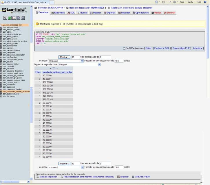

Re: Packing Slip attributes sorting randomly
Hi Linda.
This is what I get after I included 3 products with 26 attributes ( 2 of 7 and 1 of 12). I have never manipulated any value here. Are they ok? do you need another view?
Thanks again for your time and concern.
Attachment 12270Attachment 12271Attachment 12272

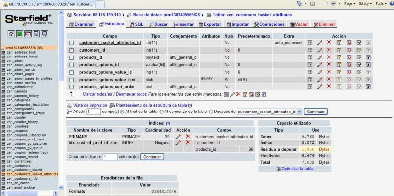

Ok, my host is GoDaddy ( :( I know, apparently not the best host). You can ask their customer service to install the application and they did it. It is a fresh new installation.
Is everything ok in the SCR4? in product_options_sort_order dropdown Function menu shouldn't be something chosen?
Thanks again.
Ok, now I am investigating more the SQL table and I have one question: I can see in SCR4 that the products_options_sort_order is defined as TEXT, and the value is 10.00001, where there should be a 10 alone.
Why is defined as text? shouldn't be defined as INT or MEDIUMINT or TINYINT (any numeric definition) so the table can read it as a number and to order the attributes in ascending order?
Will that be the problem? should I try to modify that definition?
Ok. I could finally take a picture of the sort order of the product_option_sort_order attributes. It looks pretty messy to me. Obviously there is a mistake since I define order in integer numbers of 2 in Zen Cart admin attributes order ( SCR6), and they appear with 5 decimals and in not ascendent order. How can I fix this mess? How can I define the ascendent order? Attachment 12277Attachment 12278
The Sort Order and what is store in the database table for the customers_basket_attributes will appear different, but they are looking more or less correct ...
