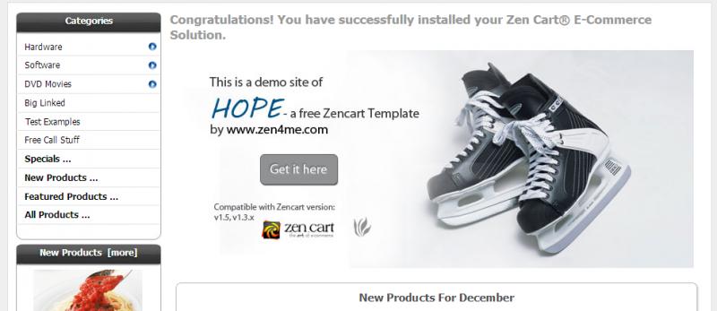

I created 3 entries (picture width 176px, height 250px) but they do not SLIDE, they apear underneath one another.
What have I done wrong?
Picture included
How can I get it to display as a slideshow?
Goshawk
Something is conflicting with JQuery.
First of all make sure you have renamed SITE/includes/templates/YOUR_TEMPLATE with your specific template name.
Then do you have any other jquery script loaded?

Try to remove this other JQuery script first to make sure that this is causing the problem.

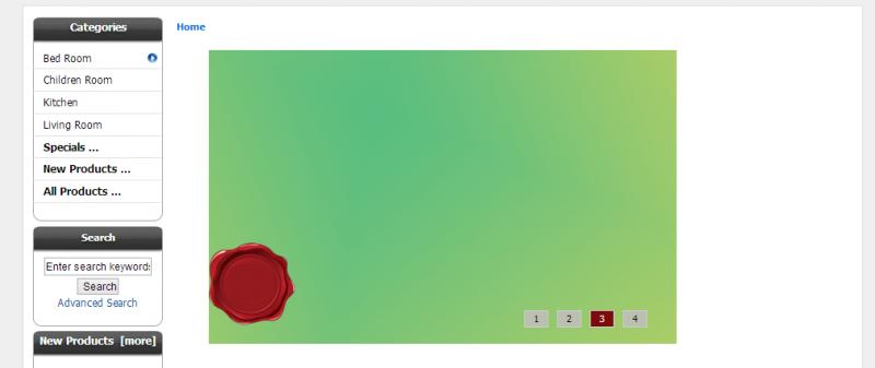

Is it possible to move the red button thingy, or even remove it completely? I'd like to have it in the lower left corner of the images I'm using.
The position of the red stamp like image that shows up under the price (if you have that active...) is controlled by the price class in the css near the top of the define_main_page.
Mine was in the lower left when it showed up with the setting:
I did throw this up on my live store while I'm working on the new one if you want to check it out - HERECode:.price{
position: relative;
top: -35%;
left: 0;
Serious-
if you were talking about the "numbers" indicating what slide is currently displayed those are positioned using the control_div id (#control_id) in the same css.
Change the left to 0 instead of 400 and it moves to the left side.

You can turn of the stamp off by changing the code to :
.price{
position: relative;
top: -35%;
left: 0;
display: none;

I tried to change the size of the slider image to 860 x 320. The height got changed but the width didn't Attachment 11638
But I want to apply slider image just like on this hope template Attachment 11639
thanks in advance
